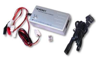

I also finished one of the battery packs last night,  and a test pack made from the 14500's I took from CS-X to ensure it'll work.  I will not include the used battery pack, but will make up another brand new pack using the greenish colored batteries seen here:
The new pack is in the saber already.  These will be 7.4v,  800mAh each.  The loose recharge port is an adapter that can be used to charge the packs out of the saber....I may still cjhange that to a difffernt type though.  I'll need to look through my parts to see what I have.  The charger this will come with is like this one here:
I'll also include the adapter wire from TCSS.

*Squeal* This is so fantastic Jay! It came out better than I could have possibly imagined. So, as far as charging goes, I can either charge in hilt if I'm just chillin' at home, or I can take the pack out and with that adaptor, charge the pack out of hilt, or on a troop, just swap the pack out for the replacement one?

Yup.  I thought it would be helpful if you're at a troop to be able to charge the depleted pack while you're still troopoing.  It might take a couple of hours to charge,  though....maybe less.
