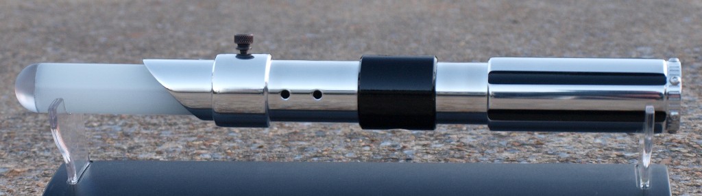

I have been putting off working on my Prophecy for a while because the US 2.5 I was putting in it was bad.  I finally got the chip to repair it so now that its fixed I decided to go ahead and start on the hilt.
I am not trying to make an Anakin out of it but am adding a control box I had machined (crapily but it will do), and adding the red and green LEDs on the side (originally decided against it but since I have a US 2.5 figured why not).
I am not doing anything with the emitter section.  Gonna leave it as is with one blade screw (didnt like two of them like the original).  I will probably take the finish off the one I have and polish the brass or powder coat it gloss black to go with the rest of it.
I have to drill holes in the pommel plug before I sand and polish it, make my switch in the control box and mount it, make a chassis for the US 2.5 and put my red and green LEDs in.  So pretty much have to do everything except the polishing (though I do need to polish it a little better) and PC.
anyway here are the pics.  Pics are clickable for larger images.
here is a pic showing the delrin I will cut down for the chassis and the control box I had machined.  I will probably cut the box to make it more narrow.  I had it cut to a different switch than I am going with now.  I have decided not to make a crystal chamber for it (what the other stuff in the pic is).
I will update it as I work on it (hopefully this week some).

I have the chassis roughly built.  I still have to smooth it out a little and clean it up but its mostly done.
The battery stick fits under the board and runs from the back to the front delrin piece (with circles cut out for it to fit in).  The wires are just there from testing and I will neatly run them when I put it together.
I have enough room in the top section between the top delrin piece and the heatsink so I might put a small crystal there.  Not sure yet.
The middle section (stepped part) is what secures the piece in the hilt.  It goes up against the stepped part in the hilt and with the speaker in it is a perfect tight fit.
anyway enough with the talk here are the pics (click to enlarge).
Love the awesome Halon Customs saber stand.
I hope to be finished with this by the end of the weekend.
