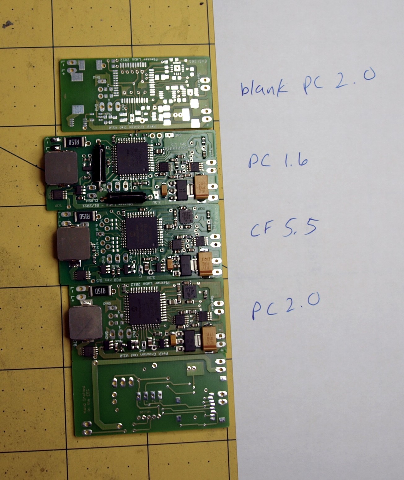

Here is a picture I took to compare the size of the board to the previous PC and CF for reference.
I also adapted the PCB to have the board header friendly. So the power supply and speaker pads are aligned to match a 2.54mm header
