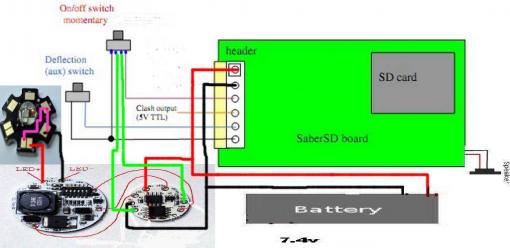

So I'm trying to get this saber I have to work with a new sound card. Short background story (I posted another thread on here about this thing): I got a replica graflex on ebay not too long ago, thinking it was only a shell... well it came with a Cyan LED luxeon type, an old Corbin LED driver, and graflex shop blade holder.
So I got some parts from an awesome smith here who's been super helpful thus far and am trying to get it to work.
The Corbin driver fires up the LED with Aux perfectly with a 4 AAA battery pack plugged into the tamiya connector that was already soldered to the Corbin driver.
But now that I've gone through the pains to carefully follow what I am interpreting the Hyperdyne Saber SD instructions and the wiring diagram I got I cannot get this thing to work.
I've got
- Hyperdyne Saber SD sound board
- The Convenience cable for the Saber SD
- Premium Speaker
- 2 Trustfire LION AAs (7.4V)
- the dual AA holder
The most I've got it to do with the Trustfires 7.4V pack is make the speaker crackle a little like static. IF the saber SD cable is plugged into the Sound board I cannot get the LED to fire.
IF I plug in the 4 AAA pack, it lights up just fine... but if I plug in the cable to the Saber SD board, the LED dies immediately. Take it out (while still using the 4 AAAs) and it works.
IF I plug in the 7.4 V directly into the tamiya connector soldered to the corbin driver, I get nothing. No LED fire. And after doing that and I plug in the saber SD cable now the speaker won't even crackle again.
I'm not sure what I'm missing... here's the diagram and then what I've done...
Anyone with ideas on what I'm missing????

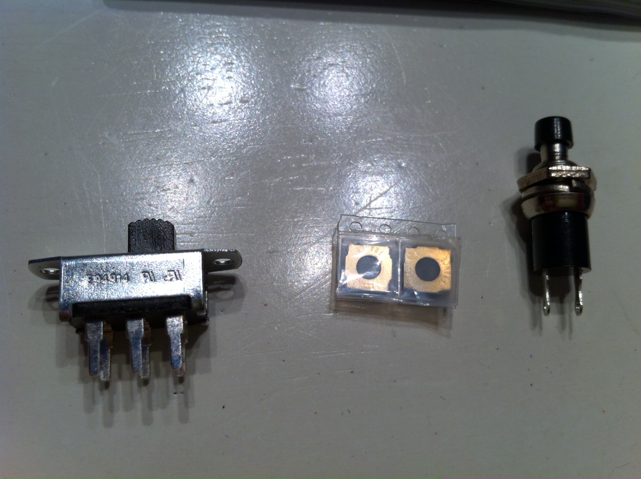

It was one of these: http://www.thecustomsabershop.com/SPST-Momentary-tactile-switch-P261.aspx
Which worked. It was only much thicker and then I got a newer slimmer one like the one pictured from LDM which has four prongs vs two on the old one, and it worked with just the corbin by itself for a little while until the saber SD was wired up. Now that same switch works with the SAber SD, but the older fat one no longer works on the aux.

Assuming that 7.4V is enough to power the Saber SD and Corbin driver, and assuming both are setup for momentary configurations, It would have to be either a switch issue, OR a connector issue of some sort. I personally never use connectors, and do wire testing using alligator clips before I install. What my brain tells me you need is a DPDT Momentary. I was in the middle of doing a hyper Saber SD install a couple of years ago, it was hard to gather much info as it's sort of a "black sheep" board around here.
In your diagram you have 2 LED drivers, a Corbin AND a TCSS driver? Or do I need glasses  :D
Have you ever gotten any aux sounds out of the Saber SD ever? If not check your soundfont, I don't remember if the default one had any aux sounds, shrug.
May be there's a bad switch like you said. I have never played with any corbin/tcss driver. Just the Hyperblade.
Also, the speaker amp on the Saber SD is for 1W 4-32 Ohm speakers. Find a 4 Ohm 1W and you will have a crazy loud saber.
Take your time and triple check your wiring every time. Also, if you find yourself frustrated, put it all down and take a break. Don't rush it, and have fun. I'll try to help in whatever way I can.

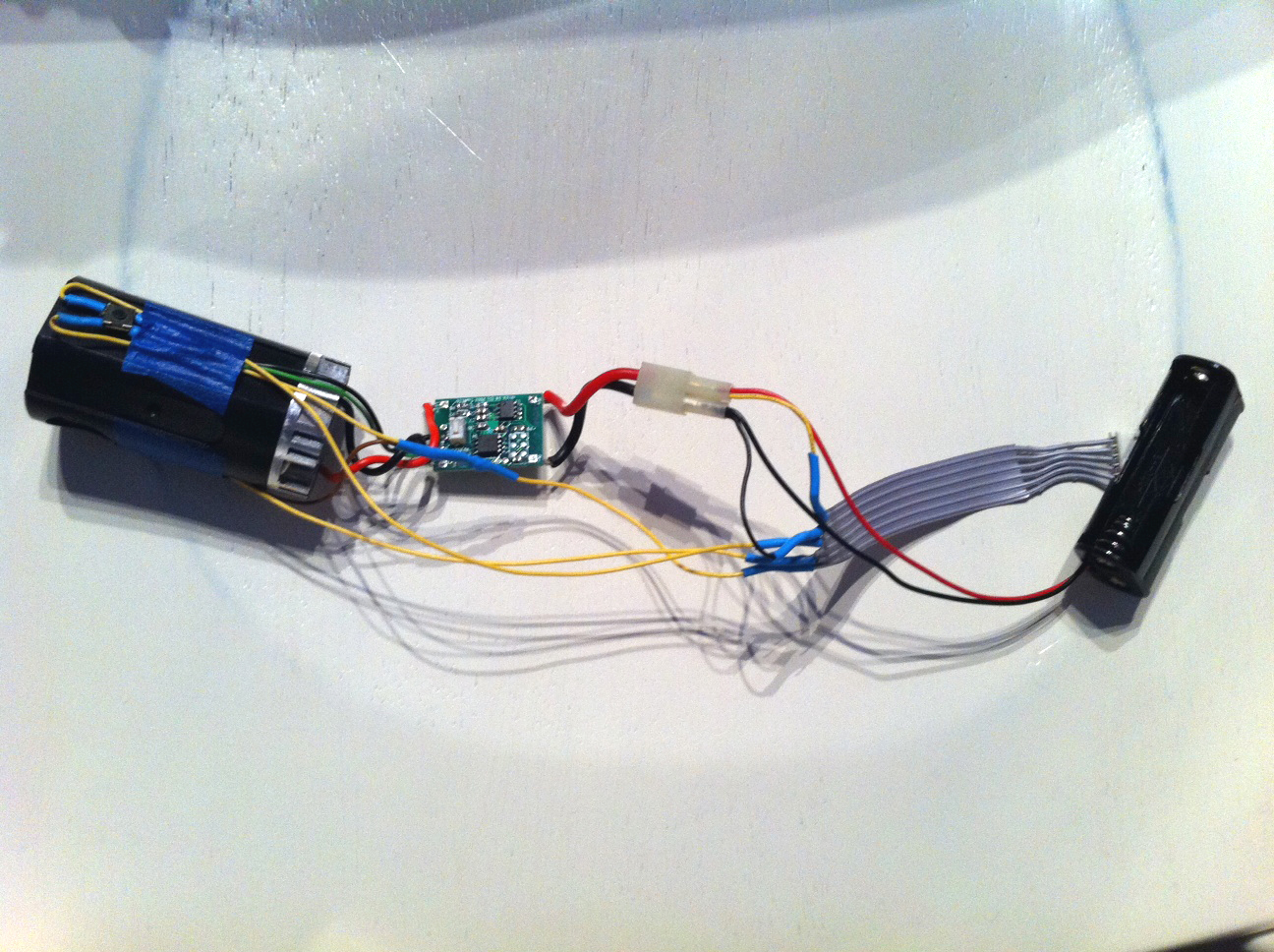

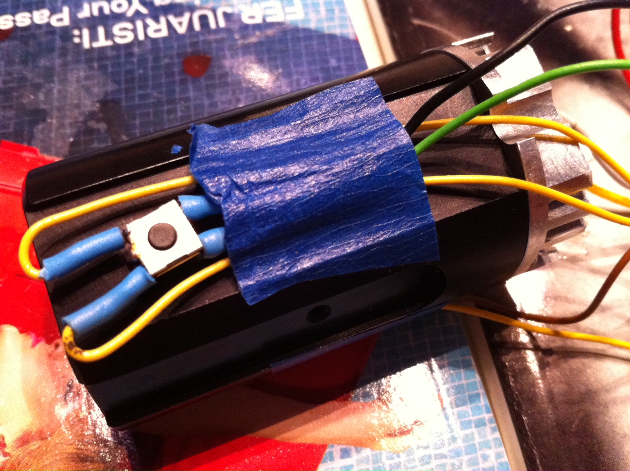

Ok so I got in a core pulse simliar to a buckpuck to replace the corbin, and a new Cree Blue LED (didn't like the Cyan) in from LDM to use with this.
Well, I got he LED working perfectly, but since I already had the one switch wired up I tried to use it, and it only momentarily has an effect (hence I assume the reason it is called a momentary switch). I have a couple of other switches and one I think is a six prong DPDT but they're all too large to be used on this graflex, all except the tiny grey ones, but their buttons are flush and I'm not sure how I'd trigger it... that is IF they are the right thing I need.
Here's what I have wired up now, and the others I have to use for now:
other switches I have, but none but the tiny flush grey ones would fit:
Also, everything was working sort of... but when I got everything clipped together to test the switches (I use alligator clips now), I couldn't get the switch to function correctly, so I switched the leads to the battery to see if I had crossed them backwards. Then the Saber SD board didn't like it, and now I get no power on LEDs on the board. I can hear static from the speaker, so I know power is flowing... but nothing.
I'm hoping it has something to do with battery power level and I'm recharging the trustfires now and will check again later...
but do you think I screwed something up or killed the board? I checked and re-checked all my connections, testing 4-5 times, and all are good power wise...
I can't figure out why that now I cannot get the board to work at all (hoping battery).
