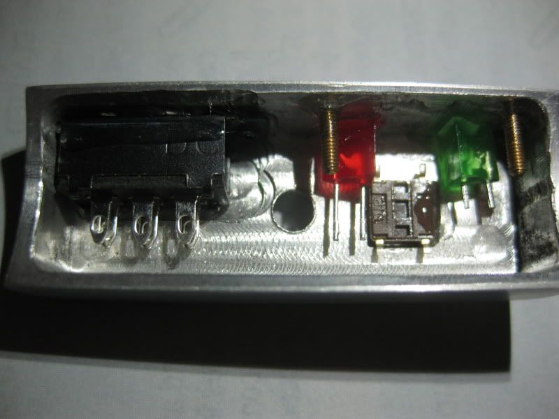

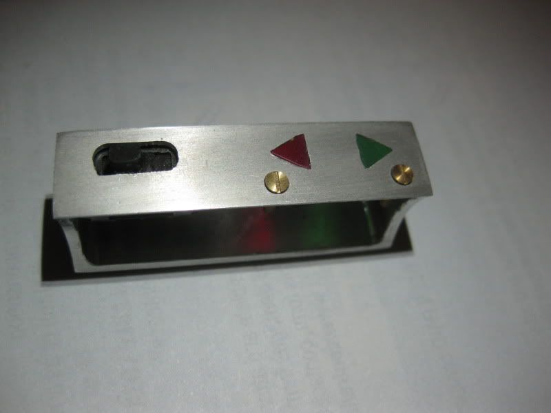

Part 2 - Control Box
This video is of the gluing of all the switches and LEDs into the control box. I am not wiring them until the end of the build.
Again, this is probably a bit boring but i am trying to document each part so whoever wants to see it can do so.
Here are some pics of the Box after it has set overnight.

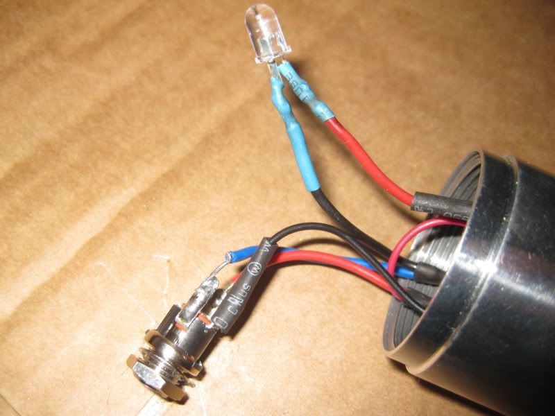

You guessed it, more wiring. This time I make a simple Y junction for use with my recharge port.
Part 5 - Recharge Port
This video is just the wiring of the recharge port, battery pack etc. I simply followed the diagram given in the PC manual.
In the end it wasn't as simple as I had hoped. I fried my recharge port, I assume by over heating it with the soldering iron.
It took a few days to get the time to go and purchase a new one from the local electronics store.
But this time I soldered it without destroying it.
My recharge port is accessed from the bottom of the saber, through the centre of the pommel insert.
Just enough wire length is left so that the pommel can be set aside to access the SD card.

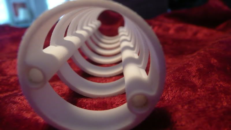

Part 7 - The Chassis
In this video I demonstrate the ingenuity of the SABERWORKS ribbed chassis system.
I try my best to describe how I have shaped the chassis to suit my components.
I was very impressed with the chassis and I must thank Ki-Adi for supplying me with one.
It was much easier than trying to make my own. For my first build, this was so useful

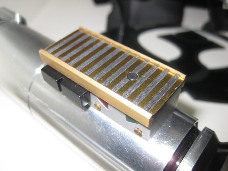

Time to put the electronics inside the hilt and wire up the control box and speaker.
With that done, the control box just needed to be secured to the hilt and the decorative features glued into place.

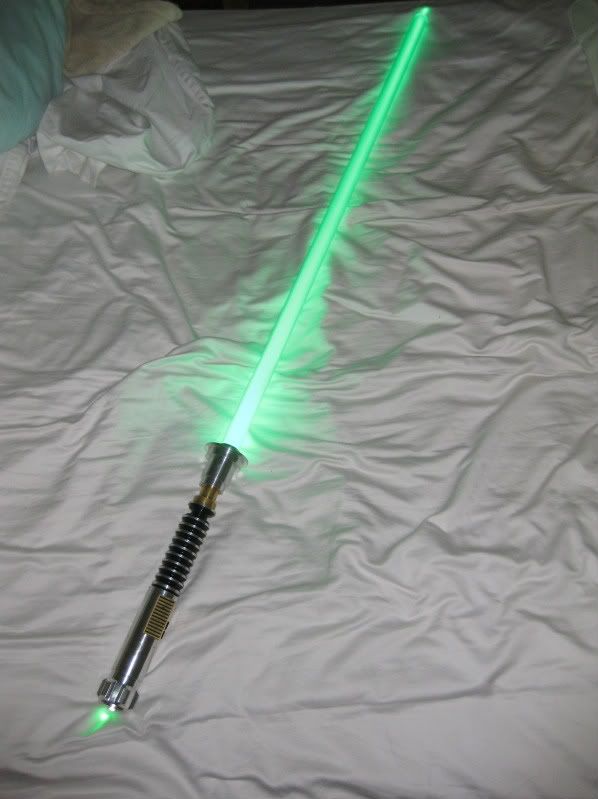

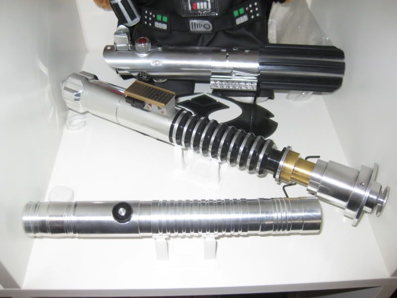

Part 9 - Final Video
This last video is a demo/review of the completed saber. I also show how to access the SD card, thanks to LDM for the idea.
blinds closed with flash_________________________blinds open__________________________blinds closed + no flash = blurrrr
Bonus Video - Demo with Blade In
Thank you, and Good Night  ;D

Completed.
Thanks for watching.  ;)
Please give feedback. Positive and negative appreciated.
Sarge

Fantastic job man... it really turned out great... Thanks for the shout I'm glad the part worked for your needs...  :)
Not a problem mate.
It really was an excellent little thing. I spent hours mulling over how to cut it up so my electronics could fit in my hilt.
Next time I think I will use a battery pack and not the battery holder as making room for that holder was tough.
I couldn't have done it without the chassis so cheers.
